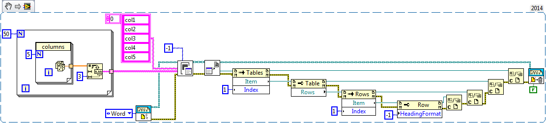

I would guess you want to repeat the header row when the table is spread over multiple pages. I don't think there is a Report Generation Toolkit that allow you to do it directly but you can do it using ActiveX methods and properties. There is a RGT vi that give you access to the ActiveX references (Word Get ActiveX References.vi from the Word Advanced palette).
Ben64
(4,658 Views)
Thankyou very much,its working
