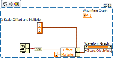

If your sample rate is 1 second that is the correct multiplier. On the timing palette use get system time and convert to a dbl. Use the time stamp from the sampling device if it is correct time. Or create a time stamp at start of sampling. Offset_mult.png
