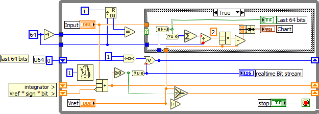

On a side note, today I would probably replace the 64 element 0,1 array with a U64 scalar, same result:
Yes, several optimizations are possible, especially if we don't care about some of the demo indicators.
