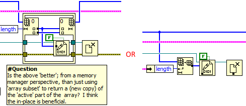

I'm carrying a pre-allocated U8 buffer array on a shift register, dumping the 'active' portion of it to disk when it is getting 'close to full'.
My overall goal is to reduce calls to the memory manager as much as possible for this particular code.  I insert data into the buffer array using in-place "array split / replace sub-arrays" which seems like a good idea(?), but when I go to get the 'data' portion of the buffer, am I better off using the in-place to get the sub-array (the size of which is close to the max size of the buffer array itself), or is it better to use 'Array Subset'?
My thinking is that the 'in-place' might be better since I'm not creating a copy of the main array, while if I wire the main array to 'Array subset' I have a branch/split on that wire, which creates a (new) copy of the whole array (except buffer allocation seems to indicate I don't on the input, but I do on the output.. sort of opposite of the in-place structure)?
On the other hand, the in-place shows two buffer allocations; the total size equaling the size of the buffer array, and another allocation on the write binary file VI anyway...

Unfortunately, I think somebody from NI will have to chime in here to get a definate answer.
But based on my limited understanding, the Array Subset will not make a copy of the entire array, but the subset you are getting.  Supposedly, the compiler is smart enough to allow the read functions for the array happen before the write functions when on the same wire (branches count).  If multiple write functions, then a copy will be make for that second write function.
I'm not completely sold on the IPES helping here based on what I just stated.

I always use a construct like your first diagram, the in-place structure.

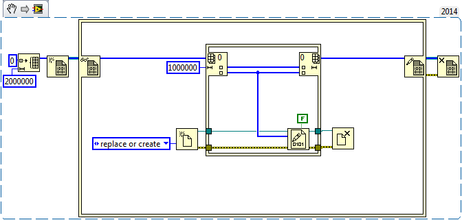

According to the LabVIEW 2014 Profile Perfromance and Memory ...
This Case 1 snippet is the best

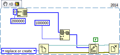

Strangely, without the DVR it is worse than the array subset, snippet below
I think you need to test in your application, ie, in a subVI with an array in and array out, if everything is inlined than not copies should be made.
