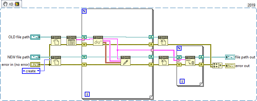

Thanks. Can you please explain more clearly your problem? In the code you are copying an old file to a new file and then writing properties to the new file. You are using some property names which are the same and others which are different. The property names which are the same will overwrite the previous value. The property names which are different will make a new property. I'm assuming that you want "Operatatore" and "Autore" to be the same, for instance, but they are not. You have to use the same property names. If you need to use the different names it would be easier to copy the data from your OLD tdms to a new blank tdms and then write your properties.

"If you need to use the different names it would be easier to copy the data from your OLD tdms to a new blank tdms and then write your properties." -> this is my case but I would like to copy the file rather than create a new one so that I would have no problem in the managment of channel and subchannel raw data. I would like to copy the tdms file, delete compleately the old property at "date set level" and set a new array of property. Is this possible?
I do not know of a way to delete existing properties, but it is not that hard to copy all of the group and channel data from one tdms file to the other. Here is a quick vi that creates an empty template (with all of the channels populated) that you can use to start your new file. You can then add your properties as you wish.
