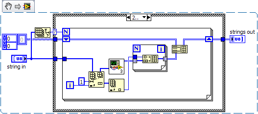

Hi John,
"can you convert for LV v8.2 please?"
No, it uses Recursion capability of LV2009... Time to upgrade?
That's the block diagram of the permutation VI:
18361i65075F082DF69BEE
"String in" is the string converted to an U8 array, "strings out" will be converted back in the main VI... (And the subVI is the VI itself - Recursion!)
