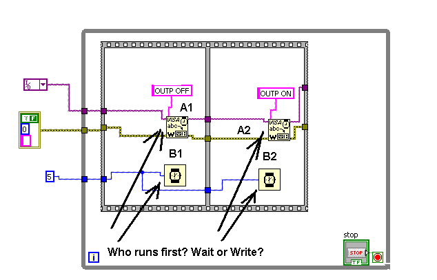

program time not stable
I try to make a program to create a pulsed voltage with a power supply. To get the pulse I have to enable and disable the output of the power supply. The problem is, that the frequency I get is not stable except the highes frequency. The frequency is limited by the power supply. Due to this I can say, that the instability is caused by LabVIEW. If I set the Wait time (see attached VI) to 0 the frequency is stable. But if I insert a value I get an instability.
Is there any chance to get a stable frequenz?

You will not get precision timing because there is noway of forcing order between the Wait and the command to the instrument.
RayR
Message 2 of 17
(4,514 Views)
I've modified your code and provide explanation with reference to the attached image.
Let's look at a few scenarios:
1.  A1 is first, B1 then B2 followed by A2 repeat.
Sends OFF, 10 ms later Sends ON, 0ms sends OFF 10ms later sends ON... And then it might be 5ms ON then OFF 5ms then ON..  and random after that.
2. B1 first, A1 next, followed by A2 followed by B2, repeat.
Waits 5 ms, then OFF command, 0 ms turn ON waits 10 ms then OFF, etc.
For the other scenarios, just use random possibilities.. which is what was going on..
RayR
Message Edited by JoeLabView on 06-23-2008 07:38 PM
Message 3 of 17
(4,509 Views)
