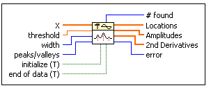

Upon closer inspection of the first VI image attached, I think I should clarify a bit more. In this attachment, a subVI called "peak detector" is being used to locate the magnitude and position of maximum values of the data array. I think this is the similar VI as the one shown here. This VI is being passed the following input parameters:
So it looks like the goal is to change the value of the "width" input manually after a certain period of time has elapsed. There was some ambiguity in my mind of exactly what this meant.
If we just want to change the value of the "width" input during future iteration(s) in the stacked sequence structure, one way would be to place a different control inside each stacked sequence structure. You could add Wait (ms) VI's inside each stacked sequence to delay the progression from sequence to sequence.
By contrast, if the goal is to change the value of the "width" input in the middle of the "X" array, then we could alter Detect Peak VI's default behavior by going into the block diagram of this VI. You might need to press "Ctrl+m" on its front panel to get an editable VI in this case. There, switch the threshold value to another added input parameter after a certain number of iterations into the array.
What is the behavior that you want to see?
Just some thoughts if you haven't solved the issue yet. Hope this helped, let me know if you have any questions or comments, and best of luck.
