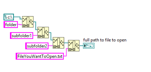

Build Path,  in the File I/O functions.

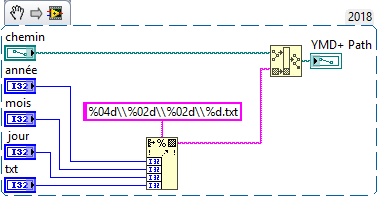

I am sorry you are having such a hard time.  Unfortunately, when you originally posed your question, some of us (like myself) didn't understand what you needed, and gave you some (probably confusing but certainly) wrong advice.  Since then, you've been given a number of suggestions, several of which may be a bit too complex for you to get quite right, judging by your last responses.
I've gone back to your original Stage.vi, where you have 5 inputs that name the Top Level Folder, Year, Month, and Day folders, and the name of a Text file.  The Year, Month, Day, and Text names are given as numbers, which I assume are meant to be the names of the Folder.  Thus a Year folder might be named "2018", a 4-digit number.  I'm assuming Year is a 4-digit number, month and day are two-digit (with leading zero), and the Text file is "just a number" (i.e. "1", "2", etc.), without leading zeros.
This code will create a full Path name from the numeric data you present (by default it creates the path "0000\00\00\0.txt", using the Empty Path and default 0 numeric values).  It does no error checking to see if such a folder exists.  It may not be what you are looking for, but I'm still not convince that I, for one, know what that is (clearly the suggestions we've been making haven't seemed to be helpful to you).
I'm hoping a suggestion, even if to the "wrong problem", will at least get you going to say "Close, but I really need ...".
Bob Schor
