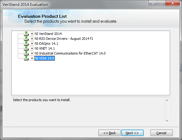

Hi Sir...
I need convert .mdl to Linux .so,I installered Veristand but can't find "NI VeriStand 2014 Model Framework".
I re-installer again,I didn't find NI VeriStand 2014 Model Framework as the feature to install.
download path
http://www.ni.com/gate/gb/GB_EVALVERISTAND/US
Where can I find "VeriStand 2014 Model Framework" install??
thanks

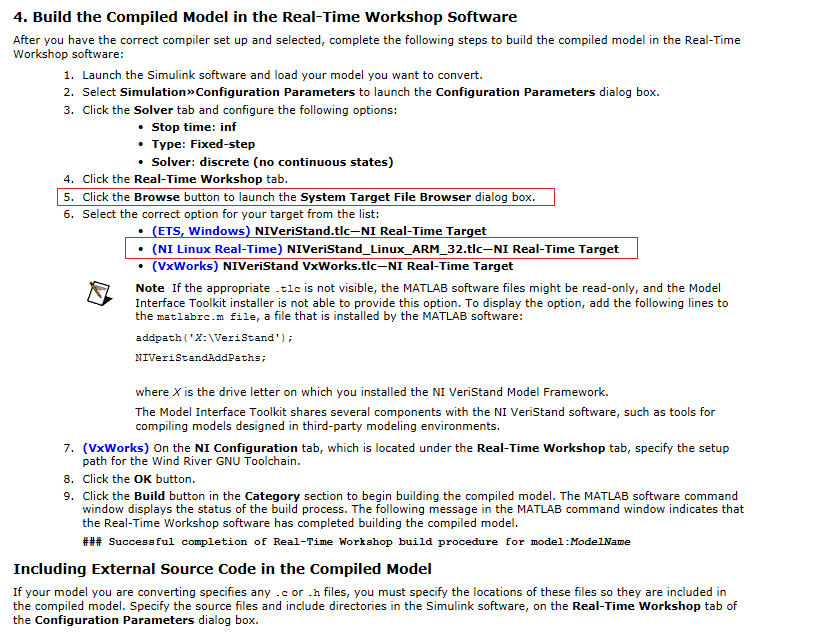

Thanks your reply....
I can't find NI VeriStand Linux_ARM 32.tlc that like below path description
http://zone.ni.com/reference/en-XX/help/374160B-01/vsmithelp/mit_convert_model_to_dll/
If I install success ,the License manager should have a Generation model toolkit,but I didn't see it!
In Matlab I had setting path..

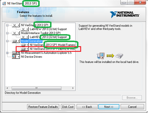

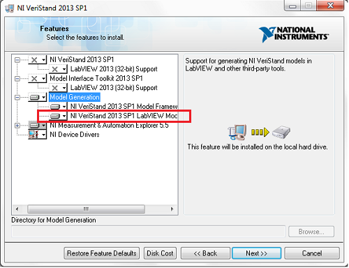

Help show the needed install feature,but 2014 installer didn't find...

Linux model support is a feature of the 2014 version, it did not exist in previous versions. It looks like you're using 2013 SP1 in the screenshots.
Its noted in the new feaures section on this page:
https://www.ni.com/pdf/manuals/modelInterface_2014readme_KB.html#New
Note: while MIT 2014 does support running models on Linux RT targets the VeriStand 2014 engine does not support Linux RT yet.
Craig H. | CLA CTA CLED | Applications Engineer | NI Employee 2012-2023

Ok so this is confusing.
Here's your screenshot, with some more boxes highlighting that you're actually installing the 2013 version:
I'm looking into why the "VeriStand 2014" Evaluation version includes 2013 SP1...
