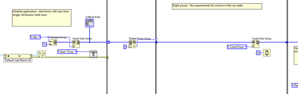

Hi idjuven,
I agree with you, there is no good reason to use an array of enums here. Maybe the creator did not know about LabVIEW queue functions, but it seems like anyone training for the CLD should be aware of them. All of the array functions could easily be replaced by queue functions, but I would probably just tweak the logic a tiny bit so that the one case where they want to enqueue 2 states instead of 1 is not necessary, and you can just use a single enum instead.
For anyone interested in how the array of enums is being used like a queue in this solution, here is a small clipping:
Message 9 of 17
(5,119 Views)
@Gregory wrote: All of the array functions could easily be replaced by queue functions, but I would probably just tweak the logic a tiny bit so that the one case where they want to enqueue 2 states instead of 1 is not necessary, and you can just use a single enum instead.
There are a bunch of array constants in there that will completely overwrite what was already in the array.  So a Flush Queue and then an Enqueue would be required for that.  Personally, I think this example could be improved by turning it "inside-out": put the Event Structure on the outside and the state case structure in the timeout case.  Then you could get away with just a single enum (no arrays).
