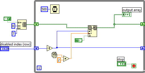

updating boolean array
I am trying to update my array the "furthest down" index needs to be updated it is also random but stays towhere it looks like the LED's are connected so... if anyone could help it would be wonderful
the second picture is what i want it to look like

The first thing I would try is using a shift register to hold your boolean array.  You are starting over and only replacing one element per cycle.

Ran out of time to edit last post.

i did try the shift register and it did work the only problem is it follows the the next indext to its spot I don't want it to do that (in other word it recenters itself over the next randomly generated index.

I'm not sure of the purpose of you initializing the array in the while loop itself... If you do that, you're basically overwriting whatever is done in the replace array subset.

very nice now all it has to do is keep updating from the bottom

I am not totally sure what you are shooting for, but you could add another shift register to keep track of a fractional index.  You could use 2 * Random[0,1] - 1 to generate a random number between -1 and 1 and then add that in each cycle.  The replace array subset function will simply pick off the integer part, you could add a round as well.

lol wow took you a while I saw the game and I figured I would try it out and the only thing I have left is making the background flow properly thanks for noticing lol

here is what I have so far

I'm still confused... But are you trying something like this?
