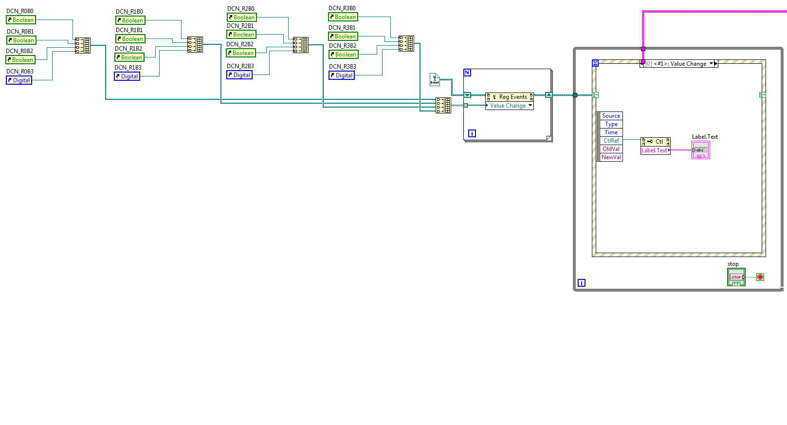

I am able to register events discretely, but when I attempt to do the same thing in a for loop, my code fails to work, and I don't see the difference between my two approaches.  First, the method that works:
works.pngNow, the method that doesn't work:
In addition to this shift register, I have also tried using tunneled output from the for loop, with both indexed, tunneled, and concatenating outputs.  When I say the 2nd approach doesn't work, what I mean is that the event structure never executes.  I made sure to go into the event editor and change the event to be the dynamic one that I'm registering...

In the second method that doesn't work you are registering ONE event instead of all of them.
In the first example you build four arrays then register each array as an event in the same node.
In the second example you build four arrays the concatenate them to form one larger 1D array.  You then auto index the array so that each iteration the next item in the array replaces the last one.  The shift register makes it so that the event reference is replaced each iteration as well.  After the final iteration you pass the single event reference containing only the last control reference to the node on the event structure, thus registering only the last digital control.

thank you for the clear explanation....
Is there a way to use a loop to register them all?  As you know, when you bring the node out of the for loop, it's an array.  I can't connect an array to the dynamic registration input of the event structure, it gives an error.

because this is a small scale test and in the full version there may be up to 100 separate arrays of controls that I would want to register.
(3,728 Views)
In your example, each group of controls for which you want to register contains three booleans and a numeric. On the front panel, are these groups similar or identical? Can you group the three booleans and numeric into a type-defined cluster? Then you can register for events on the cluster instead of on the individual control, which may make things easier. It is also possible at that point to iterate through every control on the front panel and build an array of all the ones that match that type definition, then register for events on that array.
