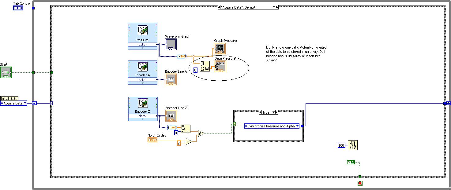

Btw, since this problem actually for my acquisition project, I would like to go back on the original VI.
I would like to get your suggestion on the array problem.
The data only show like below:
The next value will replace the previos value.
My objectives is to put all the data in the array. Do you have any idea? Do I need to use a loop?
Thanks.
-Fird-
Message Edited by Fird on 07-06-2009 04:24 AM
Message 12 of 21
(1,922 Views)
You overwrite the array all the time, that's why you get only one result.
Yo should concatenate succesive array's using for example the "Build array function as showed in the attached screen shot where MyData is the array that contains all the data and New Data is the data from each loop iteration.
Be sure to select "Concatenate inputs" whenyou right click the "Build array" function.
Hope this helped 🙂

I could if you provide me a LV 8.5 version Smiley Happy
Message 15 of 21
(1,897 Views)
Ok. Please find the attachment below.
Thanks a lot.
Message 16 of 21
(1,894 Views)
Accepted by topic author Fird
Modified version in attachment 🙂
I simulated two DAQ cards with the MAX and tested the VI.
It looks good 🙂
Hope this helped
