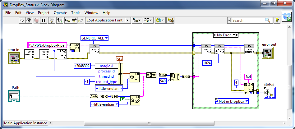

I'll have to leave a bit of the work to you since I am not really going to upload my WindowsAPI library at this moment, but here is how I monitor my DropBox status from LV:
The basic idea is that I tap into the named pipe which is used by DropBox in order to send a status request.
The three subVIs on the left are simple calls into 3 windows functions in Kernel32.dll: GetCurrentThreadId(),GetCurrentProcessId(), and ProcessIdToSessionId().  The Session Id is used to open a connection to the named pipe 'DropboxPipe_SessionID'.  The request is packaged with some number I found in the API, the process id, the thread id, and the request type which is 1.  The path is converted to UTF-16LE by blowing it up into U16 and byte swapping.  If you have funky characters in your file path then substittute a WindowsAPI function to do some real conversions (I find them to be a bit slow and obtuse so I usually skip them).  The request is padded to 540 bytes and written to the named pipe.  The reply from the pipe contains a status code in a C-string at index=4:
Code 0 = Not in Dropbox, Code 1 = Up to Date, and Code 2 = Syncing
Grab the OpenG pipes library and you should have all of the VIs you need to handle Named Pipes.  Just remember you are connecting to an existing pipe and not creating a new one.
