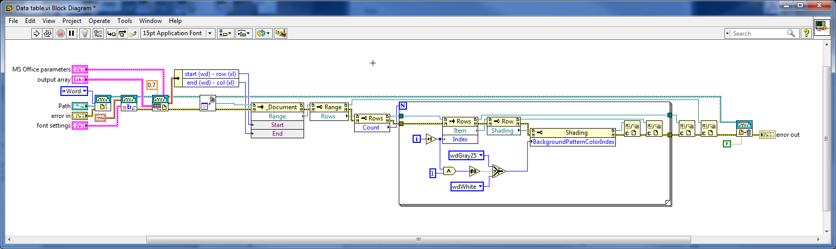

Since we can't get the table index you will not be able to use the Word Table Borders and Shading.vi
Another way to grab a table handle is to use its range. To do this you will use the range (wd) - start (xl) output of the Append Table to Report.vi, unbundle this output to get the start(wd) and end(wd) value. You will now have to work with Word activeX properties and methods.
Here is a picture that show you how to do this. Now what you need to do is to get familiar with the Word activeX objects, the RGT (Report Generation Toolkit) is usefull for basic operation but want you want to do is beyond its scope.
I strongly recommend that you have a look at the methods and properties I used in the following screen shot and use this link to look carefully at their definition and at how to use them.
Ben64

This is perfect. Works really fine. I will learn from it.
