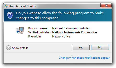

Hmm... that's curious.  From your screenshot, it looks like you're running setup.exe, and not *.msi - would that be correct?  You should always run the *.exe version of the installer.
Also, when you run the installer without rightclicking to run as administrator, do you ever seen the User Account Control elevation prompt that dims your desktop?  As of Windows Vista, there a difference between being in the administrative group, and being the actual administrator.  Even if you are in the administrative group, you need to elevate to be able to do administrative tasks.  This elevation should happen by default (prompting you with a dialog to elevate) when you run an installer, but it sounds like this is not the case for you.  Can you verify?

I'm a little confused by your statement that "it issues a message that states it must be run with high privileges and shuts down".  What does this message look like?  What do you mean it shuts down?
When I run the installer, I see this dialog:
Upon clicking yes, the installer continues for me without error.  Is this the message you see, or do you see a different one?
