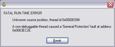

The first surprise was the appearance of the JIT-debugger:
While still reading the message, CVI got impatient with me:
It appears that CVI is waiting for the debugger, and since the debugger is waiting for my decision, I chose 'Yes'.
I started the debugger, which turned out not to be especially useful:
As mentioned before, I did have compiled the source with CVI2012 in debug mode, so I found this note a bit confusing. Of course, if 'process' refers to clang.exe, this makes more sense
After pressing 'OK', I learnt:
As I understand it, this is the way to tell me that the debugger is going to be of no help here...
