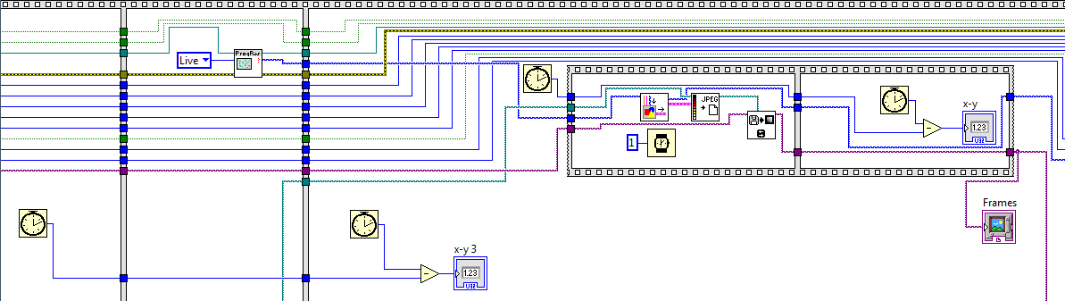

I am using jenoptik speed XT 5 core camera with labview. I would like to take the image data and to make some image processing. Unfortunately I have only one possibility using its library in labview. Here it is:
I have measured the time for execution of the function GetAcquiredImage at the begining of my code and I saw that the time around 1 second. It is very big delay for my task. May I ask how I can reduce the the execution time?

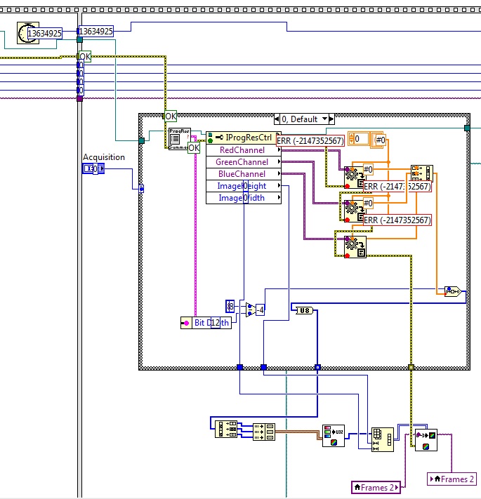

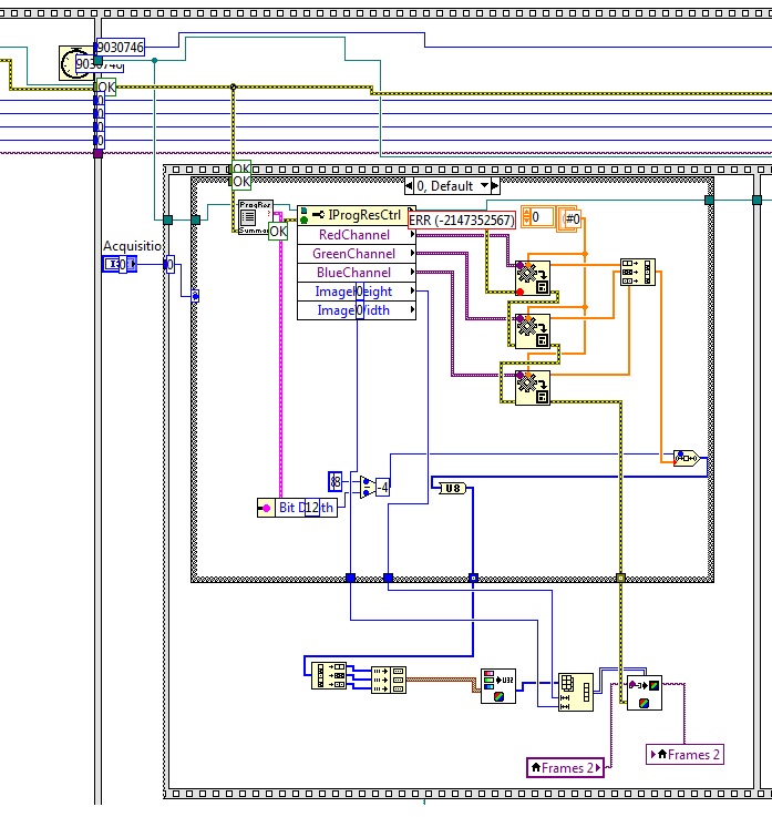

without the hardware I really can't say what causes delays but for sure you can get rid of the additional delays caused by saving and reading all obtained images to the hard drive in each iteration. I suggest you to modify "Get Acquired image" in the Jenoptik library so it could pass data directly into the desired image format (IMAQ image). You can check attached VI Snippets where is shown the modification as well as simple example of the acquisition.

Hi
Happy New Year.
I tried your suggested code but till now without success. I am sending my debug error.

I have only two recommandations. Do not split reference wire of the ActiveX session and stop using flat sequences. There is high chance that camera's frame buffer overflows with enabled execution highlight because it dramatically slows down frame reading.

Hi
The situation is still the same.
