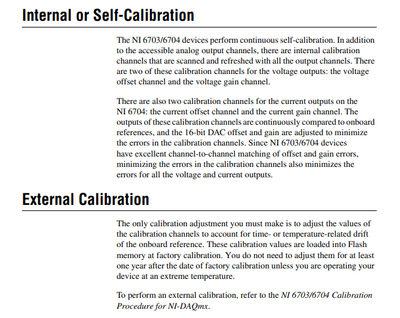

Are you calibrating the DAQ at the recommended intervals to offset this degradation?
https://knowledge.ni.com/KnowledgeArticleDetails?id=kA03q000000x1xHCAQ&l=en-US
Looks like you don't need an external calibration in most cases

It's not a calibration problem. I checked the pmos are actually broken and replacing them the channel returns to work perfectly.
