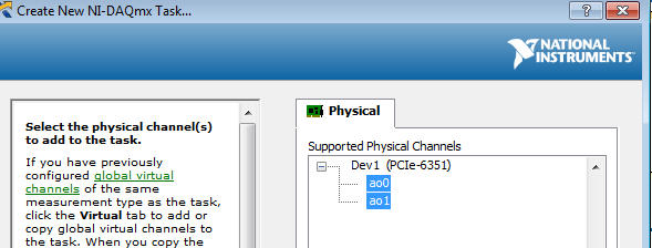

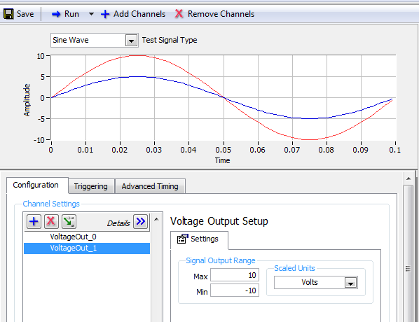

When you create the task using the DAQ Assistant (You only create Tasks once -during development right?) select both channels
Here is the Task completed on simulated hardware with AO0 set to +/-5V and AO1 at +/-10V
(5,008 Views)
Accepted by topic author Soran
Great! it works. I do appreciate your help 🙂
