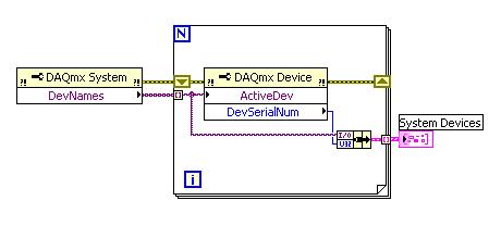

Hi qwerty-
Hopefully I can help out with your questions:
1.  There are several strategies to avoid reliance on MAX device naming.  For your case, this method of programmatically correlating device names to serial numbers should be helpful.  Note that devices will only be listed by the DAQmx System Property Node if they are physically present in the system, so this is a good way to verify the device names accessible to NI-DAQmx.
2.  This sounds suspciously like a data corruption similar to the one I discuss in this thread.  Please check my suggestions there and let us know if you're not able to resolve the problem.
