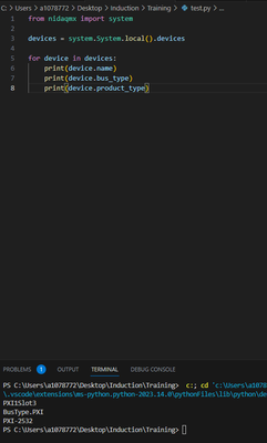

I'm trying to detect all the NI devices connected to my system to retrieve their names and which PXI and slot it is in. I can see it in NI MAX, my SMU is NI PXIe-4140 (see below).
When I run my python code, the library can only detect my switch matrix (NI PXI-2532) (see below).
Is there something I'm doing wrong? if not, is there another library I can use for my purpose?

The PXIe-4140 uses the NI-DCPower API, not NI-DAQmx. You need to install that driver via NI Package Manager and the Python library from pypi (see https://pypi.org/project/nidcpower/)
Note that although the PXI-2532 is recognized by NI-DAQmx, support for switches in that API is deprecated (and I believe nonexistent in Python) You should use NI-SWITCH (and the Python library from https://pypi.org/project/niswitch/).

You can use NI System Config API (nisyscfg · PyPI)
Use dcpowerscx (Valid Experts for the System Configuration API Functions) as the resource.expert_name
