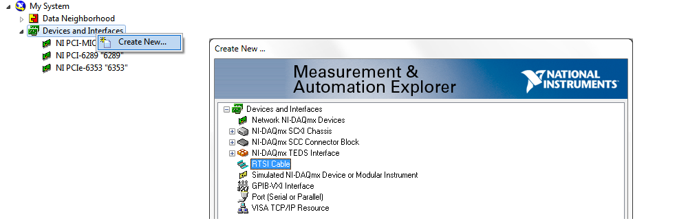

It sounds like you're almost there, but you will need to add the RTSI cable to MAX manually.  The screenshot in the link is from the older version of MAX, if you are on a more recent version it will like more like this:
Once the cable is created you should be able to add your DAQ devices to the cable.  At this point you can use DAQmx to directly route signals from one card to the other over the RTSI cable.  I hope this helps!

Thanks for the leads...this worked perfectly.  I had searched for "rtsi configure" previously and got not dice.  There was a link posted earlier, which appears to have been edited and is now gone. For good measure, I'll repost it here.  Thanks again.
