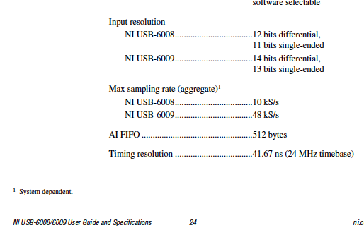

The specified resolution for the USB-6008/6009 is one bit less when using a single ended configuration. So 2^11 is the correct factor.
Lynn
