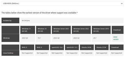

@auerdoan wrote:
It is now supported 2025
running on linux mint.  Im trying to install a basic usb 6008 trying to find the drivers
NI-DAQmx now supports Linux Desktop but does not support Linux Mint and USB-6008.
Reference: NI Hardware and Software Operating System Compatibility
