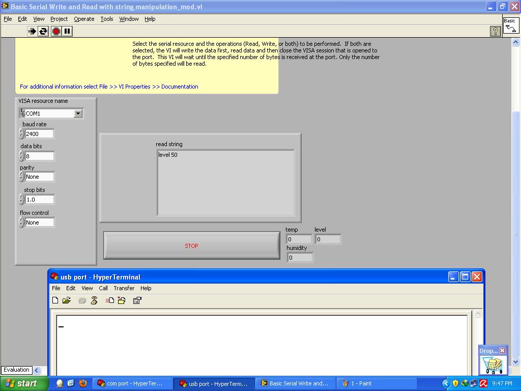

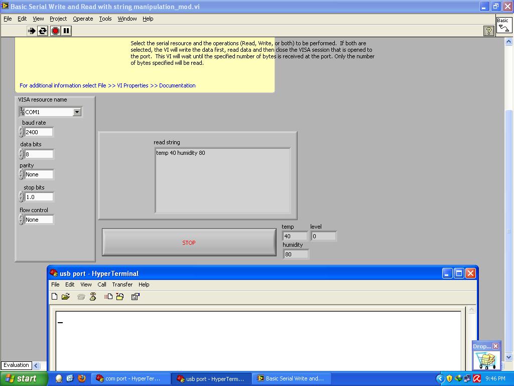

i check the GUI provided by you
1)  i dont use the external circuitry but i use the cross usb to serial cable i-e one end is usb and other is connected to system com port and i send data from usb hyperterminal to com port hyper terminal and found the loop 100% working  (im using this senario bcz theres some temporary problem in my circiut)
2) i send the data to GUI in this format "temp 40 humidity 80 " the  GUI shows the recived data also in the tabs
3) but when i send the complete packet data that is "temp 40 humidity 80 level 10" GUI only shows the temp 40 humidity 80 and level 10 in next line and level data is not shown in tab whats the reason
plz reply
i attach the images for better undrstand the problem

Hi adeelghani,
It looks to me as though it might be a coding issue as your serial to usb loop seems fine.
Could you please send me the LabVIEW code you are using so I can get a better understanding of how you are manipulating the incoming data.
I hope we can get this sorted out soon 🙂
Owen.S

Your VI also shows that you are using the run continuous button. Never do that.
It's also my VI that you are running and not Owen's. As I have said, this will work as long as you are terminating the string with a LF. It might also need to be changed if the string is longer than 100 bytes.
Message Edited by Dennis Knutson on 09-29-2009 10:28 AM

ok i noted i thing when i change in string formating form this syntax "temp%f humidity%f level%f " to "l%f h%f l%f" (where t 4 temp h 4 humidity & l 4 level ) the GUI properly works & shows all incomming strings ang display data in tabs.  so whats the reason of this ?????
and y the GUI read the strings late (time delay ) where as direct path between transmitter and reciever via cross usb to serial cable.

Obviously, if you change what is transmitted, you have to change the format string.
I asked you in my very first answer to capture the data in the VI, make current values default, save the VI and then post it. If you don't want to do this simple thing, explain why. Otherwise, it's just a waste of time.

With regards to the speed issue, if you change the "timeout" option within the code from 10000 (10 Seconds) to 250 the speed of transmission should increase greatly, if a timeout error occurs increase this in steps of 250 until it operates. Also when you change the format string the output will differ, i.e. %d will show an integer while "test %d" will show the text "test 1" for example. With serial it's normally best, where possible just to send the data you are interested in and provide formatting at the receiving end to limit the amount of data being pushed through the comms.
I hope this helps,
All the best,
Applications Engineer
