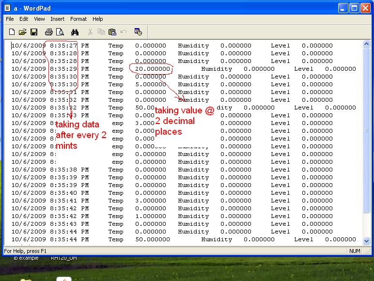

hi sir,
Can u give me the answer/solution of the following questions/querys
1)  i wana to show the two analog signals on one single graph how could i do that ?
2)  there are two states of led's ON/OFF is there any led indication which blinks (ON/OFF) continously when the condition is     true
3)   i save the data into file (using format into file tool)  the data is captured at every second of time how could i change that?, and digits of presion

The program you posted is obviously not the one you are using now since that logs every 500 msec and only logs temperature. If your current program is similar, change the value you pass to the wait and wire up a format string to the Format Into File. You can simply right click on it and select 'Edit Format String'. The on-line help has quite a bit of information on format strings.

thanks for replyng sir
i have change the value from decimal points to only decimal values 36.3232  to only 36
bt i there still problem in time logging the data   the data is logged at every instant to time i wana to log data after every 2 minuts  how i can do that
and one important thing is  "once i final my GUI then how i make the exe file of my GUI if i cant make the exe than every one can alter (made changes in my GUI ) how i can prevent that??

If you don't want to log all of the data, just place your file write function inside a case statement and use an Elapsed Time function. There is a Boolean output of that called Time Has Elapsed. Wire that to the case statement.
If you have the professional version of LabVIEW or the separate app builder, you can create an exe. Otherwise, you can password protect the block diagram.
