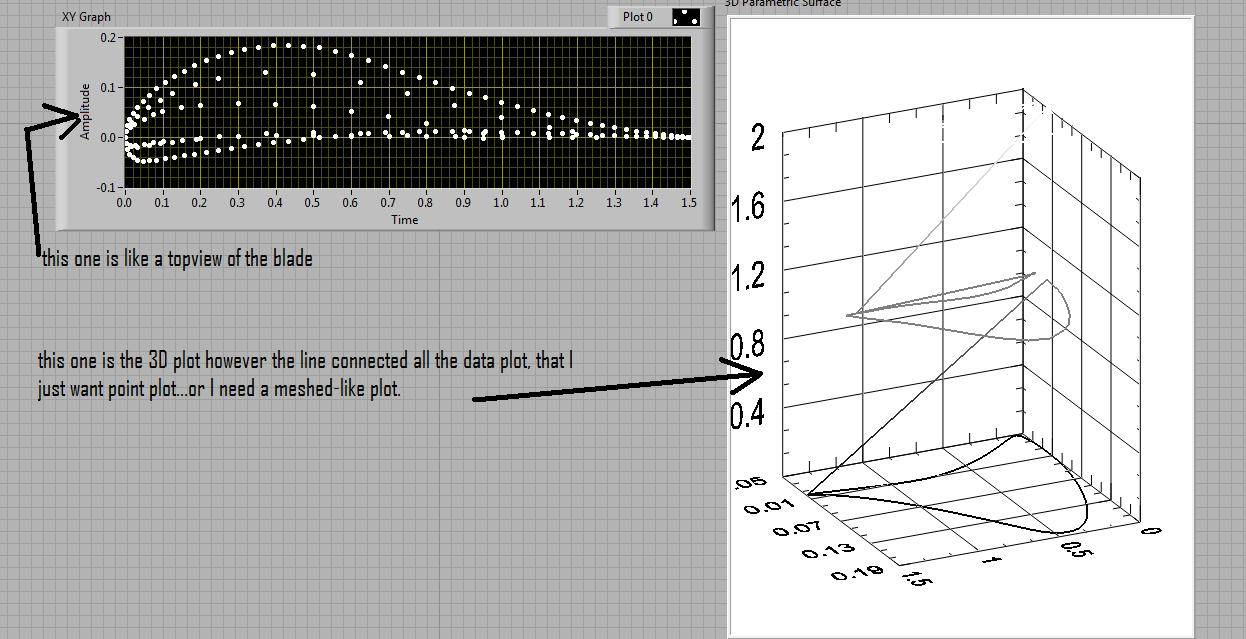

2. Im trying to plot all the point in 3D plot and gives the blade shape graph...
