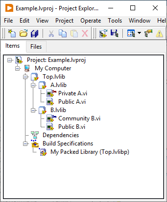

I create a library with two sub-libraries. I set two of the vi's to public, one to private and one to community access scope. And I create a build specification for a packed library. Please see the following screen shot.

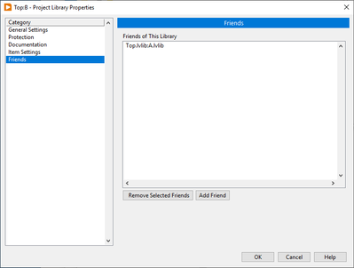

I also let library A be a friend of B (although not doing this doesn't seem to affect anything).

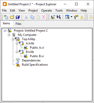

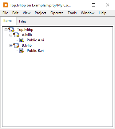

If I build this library and open it stand alone or add to a new LabVIEW project it behaves as I expect. Only the public vi's are accessible from the outside world but the private and community are not. *This is what I want to achieve*.
The packed libraryThe packed libraryThe packed library inside a new projectThe packed library inside a new project

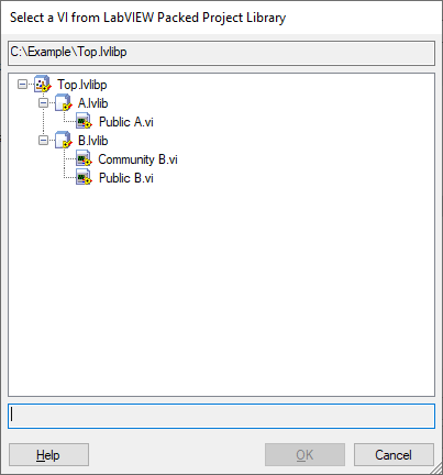

However if I open the packed library inside TestStand the community vi is accessible for some reason!? But also the private is not.
TestStandTestStand
Is this an expected behaviour? Is there something about the community access scope I am not understanding? Is there some setting I should or should not activate? Or have I stumbled upon a bug?

But normally Community B.vi could be called only by members of A.lvlib (and B.lvlib of course) right? And calling this vi in TS should not be allowed because how could you call it from complied A library? Directly calling it also should not be allowed, right? It's not in the public scope.

I have concluded that community scoped VI cannot be executed from TestStand, so there is no risk that a VI you do not want to be used by TestStand is used, but in a sense it conufuses me even more as it implies that TestStand is aware that the VI is not public and therefore cannot be used directly in a TestStand sequence.

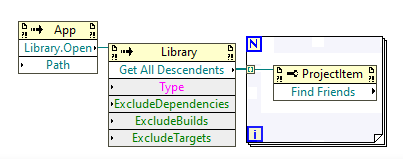

IMHO, it is a bad UX and laziness. The API already gives you properties to filter out community VIs (see screenshot). Not adding such filtering will save very little time, sweat, and money. The decision not to add it will leave a stench instead.
It can be done using ActiveX as well, so I don't see any blocking points in TestStand.
