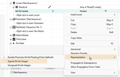

I try to return a long value from a method in a .net Adapter and try to give it a TestStand Number variable. I get the following error message in the step Settings: "Expected Number {Signed 64-bit Integer}, found Number {64-bit Floating point}"

You might wanna try to change the variable properties

Thanks for your help. Your suggestion solved my problem!
