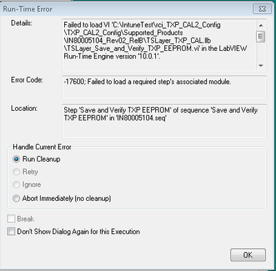

Hi guys,
Sorry to drag up and old(ish) solved thread but I'm having a very similar problem that the solution here doesn't solve. I'm currently developing a sequence that runs a suite of Labview-based tests. I'm using TestStand 2010 (4.5) and Labview 2010 (SP1).
When I run the sequence in development mode it will run fine but when I switch over to use the run-time engine just one of the tests fail and I am presented with the following error message:
The full text of this error is:
"Failed to load VI 'C:\IntuneTest\rci_TXP_CAL2_Config\TXP_CAL2_Config\Supported_Products\IN80005104_Rev02_RelB\TSLayer_TXP_CAL.llb\TSLayer_Save_and_Verify_TXP_EEPROM.vi'
in the LabVIEW Run-Time Engine version '10.0.1'.
LabVIEW:  The VI is not executable. Most likely the VI is broken or one of its subVIs cannot be located.
Select File>>Open to open the VI and then verify that you are able to run it.
VI Path: C:\IntuneTest\rci_TXP_CAL2_Config\TXP_CAL2_Config\Supported_Products\IN80005104_Rev02_RelB\TSLayer_TXP_CAL.llb\TSLayer_Save_and_Verify_TXP_EEPROM.vi"
This seems to be a standard run-time error from what I've read.
The steps I have taken so far are as follows:
Mass-compiled all relevant libraries.
Installed TestStand2010Patchf1
Replaced the error.llb file
Checked all associated file paths.
None of the above steps have helped. The path highlighted above is a valid path as other module calls in the sequence are calling from the exact same linked library and run flawlessly every time using the run-time engine. Any help would be appreciated.
Alan
