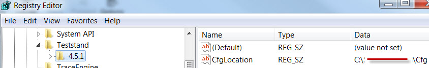

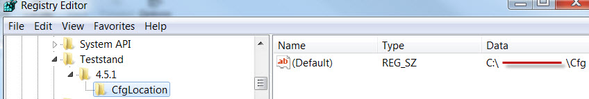

Hello-
I'm having the same problem. Teststand 2010 SP1.  Interesting side note...A coworker can change his directory and he does NOT have the registry key, which is weird.  Anyway, I tried creating the key in two places, and neither of these are working!  Can somebody look below and confirm which or neither of these is correct.  Why isn't this working?
Thank you!!!

Hello Harvster,
Delete the first one, second one is correct.
