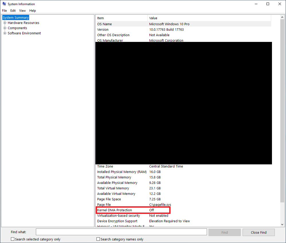

Hi Mike,
Does your computer have Kernel DMA Protection enabled? We're investigating whether this might be the issue. You can find if Kernel DMA Protection is enabled by looking in System Information. If it's enabled, you should be able to disable it in the BIOS Setup Menu.
Message 7 of 33

Hi Captain_K,
Yes, it appears Kernel DMA Protection is enabled on my machine that crashes. The BIOS is locked by my IT department. I can see if they would be willing to temporarily disable Kernel DMA Protection so I can run a quick check.
Of note, I also checked the temporary loaner machine I requested as a stop-gap for this problem and Kernel DMA Protection is disabled on the loaner machine (which does not crash when I connect it to the chassis).
-Mike
Message 8 of 33
