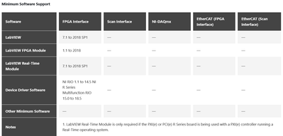

Also, noticed that the PXI-7811R is in the "Obsolete" lifecycle and the latest version of LabVIEW the hardware is compatible with is the LabVIEW 2018 SP1.
What version of LabVIEW are you using? 
You can look up
software compatibility with this hardware bellow (can find it here as well).
