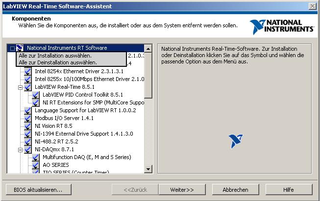

If I install the Software on my PC-Realtime-Target using MAX I got this error in MAX
>> 0xBFFF003A (VI_ERROR_INV_SETUP)
>> viFindRsrc returned 0xBFFF003A (Unable to start operation because setup is invalid (usually due to attributes being set to an inconsistent state).)
>> Please make sure VISA is properly installed on this system.
>> Possible causes for this error:
>> 1. More than one Passport may be attempting to claim the same resource.  You can try disabling Passports to figure out which Passport is causing the error.
>> 2. You have connected multiple unconfigured plug-and-play devices that have the same resource name. For example, the vendor ID and serial number may be the same.
but this error only appears if i install the Software using the install all software button in MAX (see Picture)!
If i install selecting the software parts single one after an other (klicking on the first on select install this software, than second one.... after all are selected I klick on Install now)
the error doesn't appear and VISA works well.
