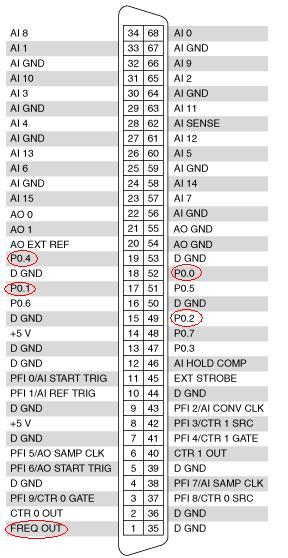

For E-series devices, when you have any multifunction DAQ board configured to control an SCXI chassis, lines 0, 1, 2, and 4 on port 0 are reserved.  If you try to access these reserved lines from the DAQ board's test panel in MAX, the reserved lines will either be grayed out, or you will receive an error when trying to use them.  Lines 0, 1, 2 and 4 on port 0 are equivalent to P0.0, P0.1, P0.2 and P0.4, respectively.  These particular reserved lines are circled in red in the pin-out of the PXI-6052E below:
