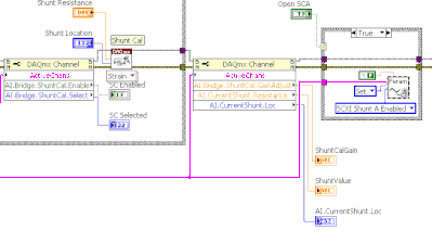

No, using the AI Parameter VI did not work.  It produced the following error,
This is what I did:
Message Edited by Greg Reynolds on 04-02-2010 12:27 PM
