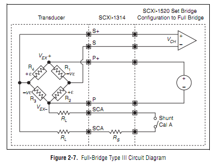

Are you attempting to read this using a task in MAX, and express VI, or low-level DAQmx calls in LabVIEW?  Further, are you creating a Strain task, voltage task, or custom votlage with excitation?  Another thing to check would be that the setup is in accordance with the diagram for Full Bridge III here:
Are you using internal excitation or external?  What have you specified for your poisson ratio?  Have you verified the connection diagram to the 1520?  This is listed on page 2-8 of the specifications.

Hi, thank you for the response.  I am reading this task in MAX, it is a strain task, the excitation is internal 2.0v. poisson ratio is 0.3.  The connection is correct.  One piece of information I would like to have:  In the MAX task, there is a shunt calibration.  My SCXI-1520 has a 100k resistor in both SCA & SCB slots.  What equivalent micro-strain does the 100k resistor represent?  I am reading approximately 635 micro-strain "simulated".  Yet charts from other sources indicate a 100k resistor should simulate approx 1300 micro-strain.  Any ideas on this?
