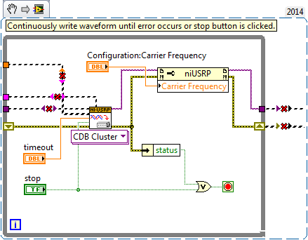

I want to be able to give to the transmitter a range of frequency and a specific time for hopping.
for example from 860M to 960M and time for each hop is 1ms for example...how can i do that ?

Hey Eldokch,
You can change the carrier frequency of the transmitted signal on the fly with a property node and the "Configuration->Carrier Frequency property.  Also, this post has some good links to other people doing frequency hopping.
http://forums.ni.com/t5/LabVIEW/How-can-I-implement-frequency-hopping/td-p/1930487
