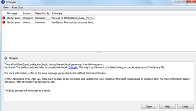

Also, I tried creating the niVeriStand_rtw from my .mdl, but I get the error as shown in the "build_error" picture. I built and imported the model sucessfull with no problems the first time around in MATLAB, but the second time I rebuilt the niVeriStand_rtw, it gave me this error.

I gave another look to the build_error.PNG you uploaded. Its quality makes it hard to read, but I was able to understand something about referring to an error messaged generated in the MATLAB® Command Window. Can you tell us something about that error message? Can you upload the picture with a better quality, showing the whole Summary column?

I can't create the .dll for the simple project model or any other Simulink models. I have uploaded the error messages MATLAB gives me in the folder below.
I'm using R2011b MATLAB and Microsoft Software Development Kit (SDK) 7.1  C compiler.

I found the solution. For some reason, MATLAB thought I had Visual Studios 2010 which conflicts with the SDK compiler I was using, so I installed Visual Studios 2010, and then went to the following article and installed the service pack: VS 2010 SP1 they mentioned
Then in MATLAB, I ran mex -setup and switched my compiler to the Microsoft Visual C++ 2010 Express.
This fixed the issue with the dll in MATLAB.
