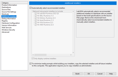

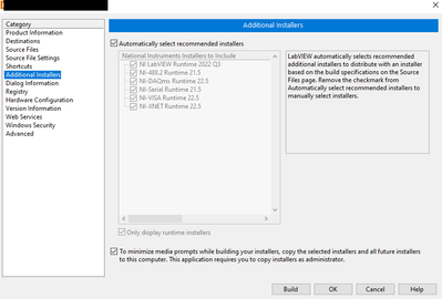

Below is an image of the included installers automatically selected from the installer.
EDIT:  I also have installed Python 3.9 but haven't done any of the system pathing stuff from this article

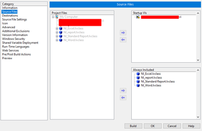

I am using OO to design the code.  I found this video seeming to add some NI directories to his project then adds them to the executables for LV 2013.  It appears that the directories are OO related (Vi names are like Get LV Class X).
When building the executable, I am telling it to include all my classes.  I am not including the three directories that the video added.

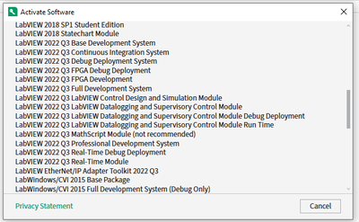

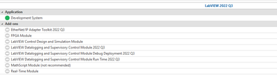

I was looking over my licenses stuff and I think I may be closer to figuring things out.  We were using LV 2018 for a while then recently upgraded to 2022 Q3.  I think my company bought the Professional copy of LV 2023 Q3 (image attached below as a third image).
If I am reading my licensing correctly, if I want to actually build a deployable copy of my code that doesn't require a full copy of LabVIEW, I will need to build in 2018, correct?
Matt

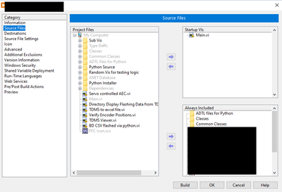

@AeroSoul,
I have my classes set to "always included", see image below. Classes are classes that I made for this specific project while Common Classes are classes that I use everywhere (such as PS class).
 Additionally, here are the installers that are being bundled with my installer, see image below.
I have verified that the executable will run on a different PC with the full LV dev installed using the installer.  Note, the installer was "rebuilt" from the one I sent to the fresh PC, but that rebuild was to push the updated executable.  Nothing was added or removed from the installer.
