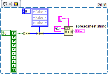

Convert the boolean array to num.
Coerce to Type (where type is an array of enums of "False","True")
Then Array to Spreadsheet String.

IMHO You need to go through basic LabVIEW Tutorials, Mainly on data types and Arrays.
Array will support for Same Data Type, You are trying to build String with Numeric datatype.
Based on your snippet try building after converting to String Datatype.
