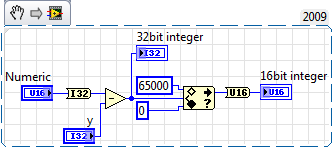

I have a 2d array that is u16 (0-65K) and trying to subtract a "dark" from it. The problem is that it sometimes yields to negative numbers and it does a wrap around and shows the values as 65K. Is there a truncate function or something to make them zero. Sorry if this is a simple question. I have only been doing labview for a couple of weeks.

Have you considered casting the U16 to I32, making your subtraction, coercing the value such that it does not fall below zero and finally casting it back to U16?
I don't know but this might work for you...
Cheers, Matt

Thank you. That works.
