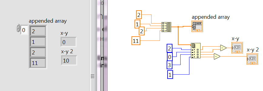

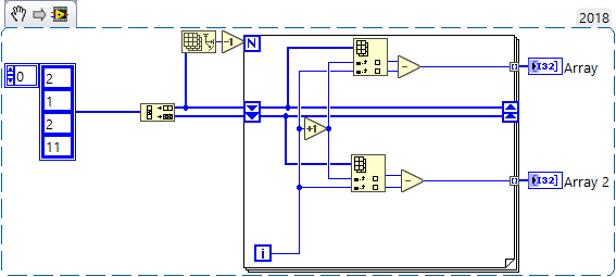

Will that scale?
How about
mcduff
Message 23 of 43
(1,599 Views)
@DickHutchings wrote:
I think I found a good way to do it.
A couple of crossed wires is better than a pile of blue wired indices.

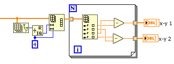

Will it scale? That could be a problem.  It needs to do the math on 1, 2, 3 or 4 supplies.
What is "it"? Please always quote relevant sections when replying. There are many posts above.
How many elements per supply? Two or four? (e.g. If there is only one supply, what's the value of the second element?)
If each supply adds four elements to the array, you could do something like that...
Please show us typical arrays for 1, 2, 3, and 4 supplies so we can understand the problem.

@mcduff wrote:
Will that scale?
Your shift registers serve no obvious purpose. regular, non-indexing input tunnels would be sufficient.

@altenbach wrote:
@mcduff wrote:
Will that scale?
True. But maybe the OP wants to interleaves the arrays at the end to recover the original array, or do something else with the decimated arrays, I have no idea, just leaving options available. But if the array is not needed then you are completely correct, no shift registers needed.
