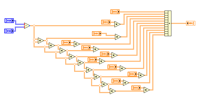

In my VI I have some code that looks like this --
Each array is 2D sized 512 by 640.  The time it takes to run this entire chain is around 28miliseconds. Seems fast, but I need to cut it down to around 10ms!  I have tried to make them 1D arrays, but that only saves around 2ms.  I even tried to chop up the 1D array into half and duplicate the code and then combine at the end (a half-hearted attempt at multi-core optimization) and that showed zero improvement...

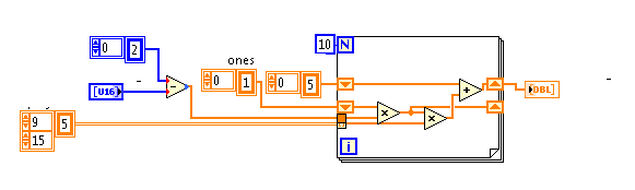

@nathanD,
Is this the configuration you had in mind, I must be missing something because my output is wrong... but also it runs almost twice as slow!!!

Yes, that's what I had in mind, with a couple of changes:
1) in place of the "zeros" array, use the array that gets added at the end (outside the loop) as the initial value of the shift register
2) convert the result of the subtraction to double-precision outside the loop, rather than allowing the automatic coercion to do it inside the loop (possible this gets optimized out, I don't know).
3) don't use a case structure inside the for loop. Use either a 3-D array, auto-indexed on the for loop, or an array of clusters where each cluster contains a single element, that element being a 2-D array.
4) this last one is a bit obscure, but swap the position of the inputs to the "add" node inside the for loop. I seem to recall reading that math nodes will reuse the upper input as the output when possible, and in this case you want that to be the shift register.
I also wouldn't bother with the "ones" array as a control; use the "initialize array" function instead. You might change the other arrays to constants, if they won't change (or at least if the user won't change them from the front panel).
I don't actually know that this will be faster, it was just a theory worth testing. It would be interesting to take a look at the buffer allocations in both versions. Can you upload your code, preferable for LabVIEW 2012?
