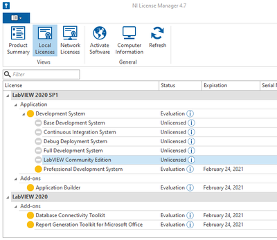

I installed a trial version of labVIEW professional before I found out about the CE edition, so at one point I had both. I thought the pro edition was interfering, so I uninstalled everything and reinstalled CE again (everything from the same, brand new, account). I'm on Windows 10.

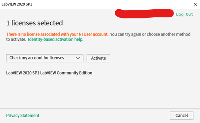

This is what I see:
I can right-click LVCE and click activate, and that menu just says there was no activation code with my account:
I tried doing an activation code submission form, but I don't have a serial number because I have no network license. I think I still have conflicting versions, or something, on my system, but that doesn't explain why I can't get this one program to activate, and I've spent a lot of time going back and forth and being confused. What can I try next?

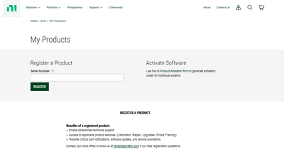

And My Products shows nothing:
