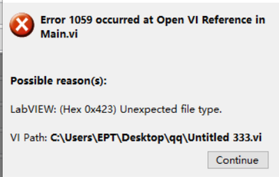

here is the error from the EXE:

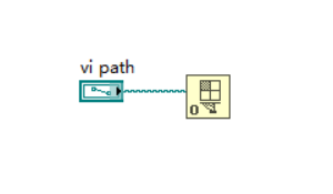

Thank you for your advise,but in my program I open the VI Reference by vi path,i do not use current vi path or other path.Just like this.It is a absolute path

the error message mentions an "unexpected filetype": do you really try to open a reference of a VI file?
Can you attach that "untitled 333.vi" file?

1,error:"unexpected filetype" may be my computor installed encrpytion software

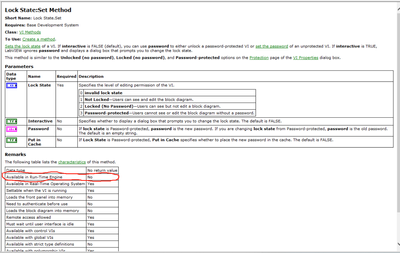

2,In my program i uesd the  “Lock State:Set Methord”,However it do not available in the Run-Time-Engine.
