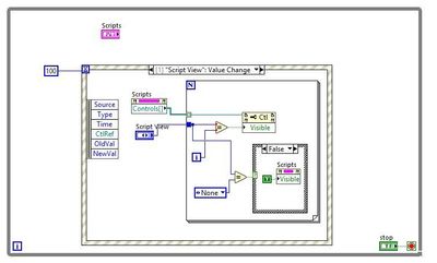

Here's one possible idea. See if it can give you something to start....
(Note that the cluster order matters, of course, so make sure they match)
Message 18 of 25
(1,732 Views)
This is doing what I want. Thank you
 It is cleaner to keep the container visible, because the space is wasted anyway. Here's all you need to do:
Message 20 of 25
