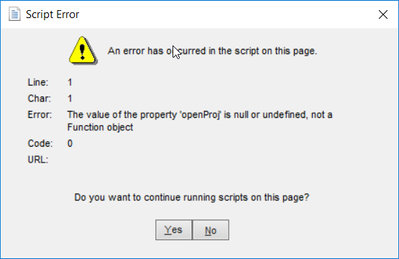

Whenever I click on Find Example anywhere in the LabVIEW help, I get the following script error and the example does not open.
"An error has occurred in the script on this page.  The value of the property "openProj" is null or undefined, not a Function object"
2018_11_01_14_50_10_Script_Error, Help when click on Find Example.png2018_11_01_14_50_10_Script_Error, Help when click on Find Example.png
It works fine on a different computer, so I located the example file and verified that it does exist on the problem computer.
The separate Example Finder tool (Help->Fine Examples...) works ok (opens examples) as well.

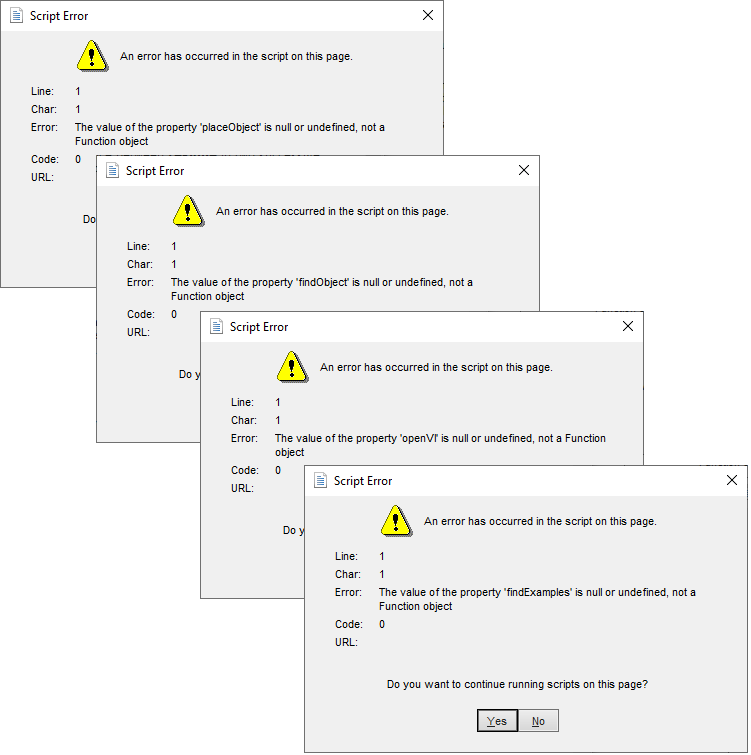

I get this error when I click on anything in the help file that requires a script, such as clicking the [+] button to add it to the block diagram.  Windows 10 LV 2012, LV 2015, LV 2016.  It just noticed it happening yesterday or something like that.

I am seeing the same problem here. (LabVIEW 2018.0f2, Windows 10).
Any button in the help:
  • Add to block diagram
  • Find on the palette
  • Open Example
  • Find related examples
